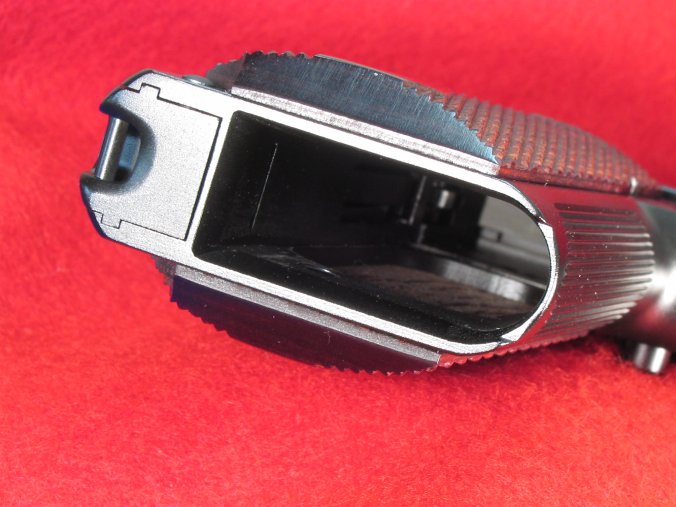

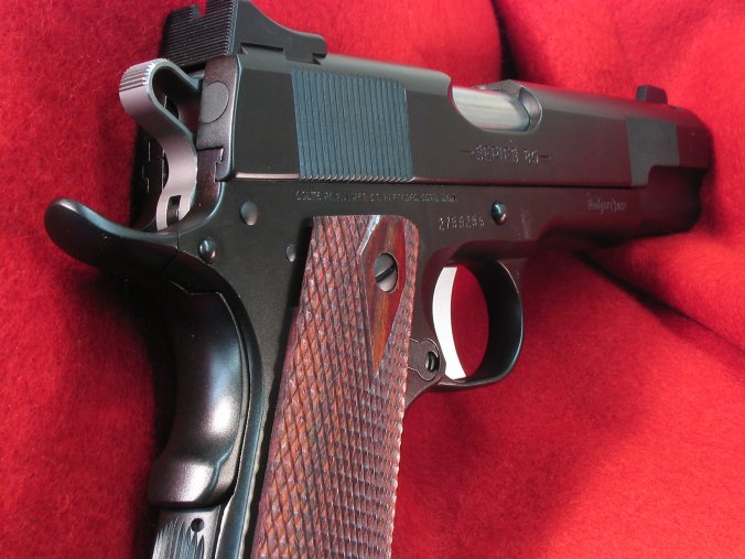

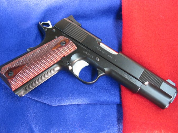

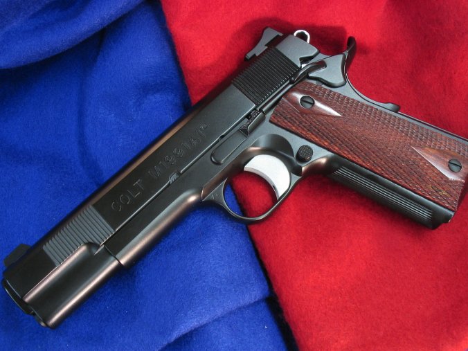

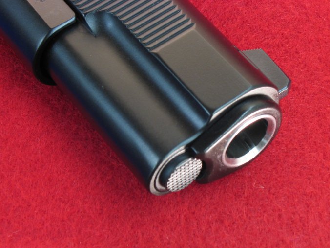

Here are some shots of a Colt Chuck and I did for forum member deltaopwong. He hasn't seen his pistol yet, so you guys are getting a peek before he does. I'll get it in the mail to him within the next few months so he can have it under his tree for Christmas...next year.:p
Chuck did the machining at the owner's request, and it's perfect - a great job. Heck, 'bout all I had to do after that was a little reliability work, fit a barrel, put it together, and kick it out the door.:)

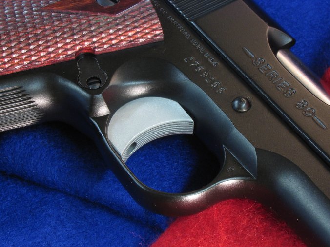

Greider solid trigger, McCormick mag catch and grip safety, EGW slide stop, and a Brown thumb safety - reprofiled. The finish is Enviro-Tech over Mil-Spec Parkerizing.
The Heinie rear sight is dehorned and the ejection port flared and blended. Chuck high cut and serrated the front strap at 20LPI, machined the front grasping grooves, and "ball cut" the recoil spring tunnel.

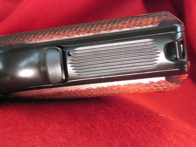

Chuck serrated the mainspring housing to match the front strap and cut in a flush lanyard loop.
The slide top is flattened and serrated in an arrowhead pattern. A Kart barrel was fit and the ejection port edges were softened.
The barrel is recrowned at 45 degrees, the EGW bushing is recontoured, and the front sight has been profiled and hand serrated at 40 LPI.
The pistol has Cylinder & Slide trigger components and the 80 series parts were retimed. Trigger pull is set at at 4 pounds.
Dehorned for carry...
The magwell got a "subtle", hand filed bevel. The lanyard loop edges were softened to protect the heel of the hand during mag changes.
Hope you enjoyed the photos. Please don't tell deltaopwong his pistol is smeared all over the internet! Thanks for looking.

Damian, This would be my 2nd. 1911 done by Bob. When I received my first 1911 (Springfield Operator) back. I couldn't stop staring at it and evertime I picked it up to admire Bob's workmanship, I would find another subtle detail that he had touched up on. Absolutely amazing! This Colt is pretty much what I had envisioned it in the beginning when discussing it with Bob last June. After sending it off to Bob and like most guys, decided to add/change something 'since it's already at the smith and might as well have it done before regretting later on'. I originally had envisioned a more GI look to the Colt (ie. rounded top, no front cocking serrations, no ball cuts). After looking at numerous pictures of custom Colts and Springfields out out there, I found that guys would usually go the extra mile on their Colts (the Colt name still has that certain mystique) and have the extra frame/slide machining and the Springfields were kept more inline with the GI look. At the end, I had Bob add the ball cuts, flatten and serrate the top of slide with the arrowhead pattern and the front cocking serrations to match the rear to my work order. I would like to thank Chuck for doing such a great job on the machine work and the beautiful MSH. I would especially like to thank Bob for all his wonderful work on this Colt on it's entirety and making this project gun a reality. This Colt has everything that I would want in a 1911 and will be my retirement carry gun..Stan
