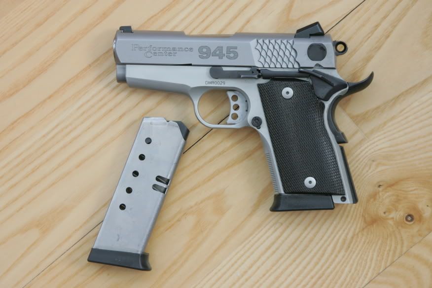

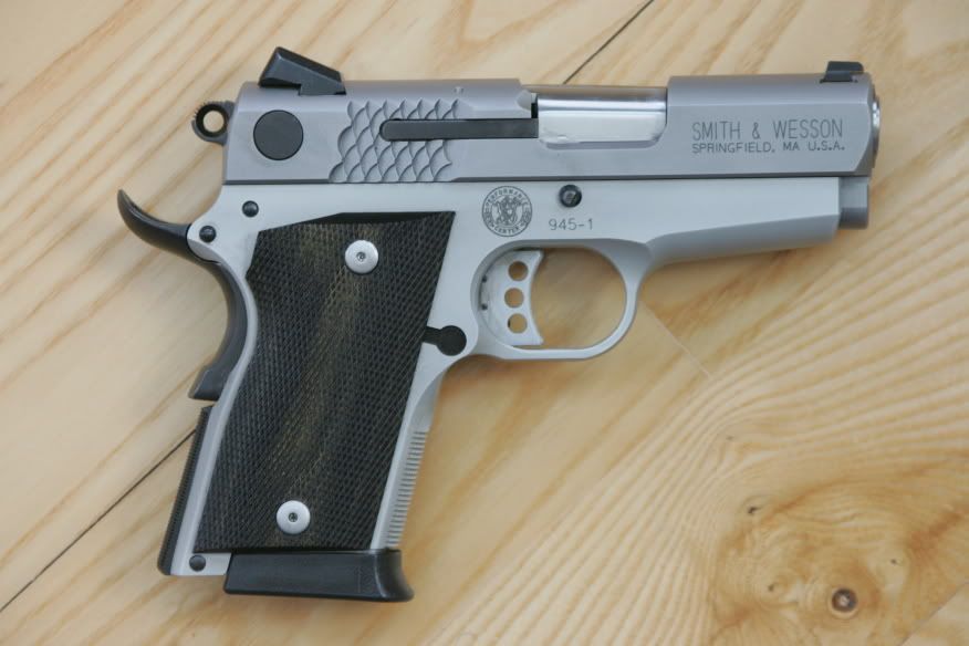

The 945 is a gun that should have set the world on fire for S&W but somehow never managed to do so. I have two of the early production models, a full size (5") 'black' model and one of the 3.25" all stainless.
(Here is a photo or two of the latter.)

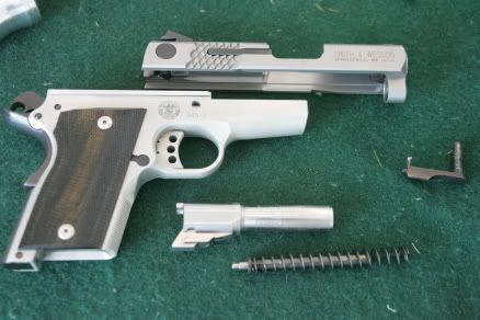

Most people do not understand just how different the 945 (and the later 952 and PPC double stack guns based on it) are and assume they are just a modification of the 'normal' 1911. Wrong!
The basic construction is quite different, with a lock up system and barrel arrangement that is, IMHO, a 'step up' from the older design. See below:

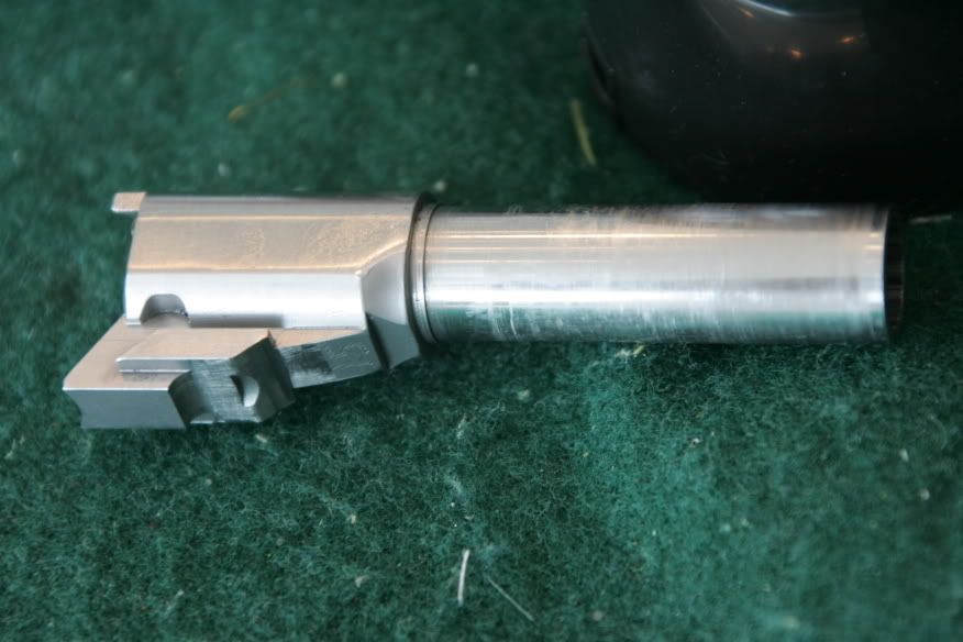

The barrel is shown here:

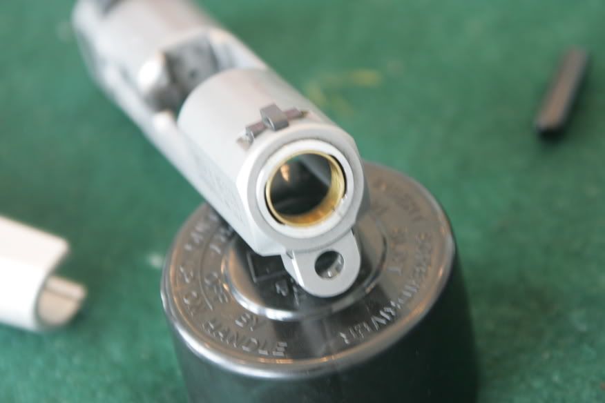

The Briley style bushing, which makes for improved accuarcy is here:

I have torn down both the full size black 945 I kept along with this gun and a SS 945 I traded off. Bit to bit, as you can see above, the gun is simply a shortened 945, not another S&W Auto "that they dressed up."

Though I've not had a 945 in the shop, it appears, in large part, to be a large frame S&W auto (such as the 4506 or 1006), with the needed changes to adapt it to the 1911 type fire control system and safeties. I've worked on a 745, and converted a couple of 645's to SA years ago, and the barrel lockup system on the pictured gun is textbook S&W auto, as is the slide. It appears as though Smith did the usual conversion on the slide to do away with the hammer drop type safety, and that probably makes it work just fine with the converted lower. Smith has had the ability for a long time, to convert their autos into something a bit different (such as making the Model 39 into the Model 52), and they always seem to shoot.
