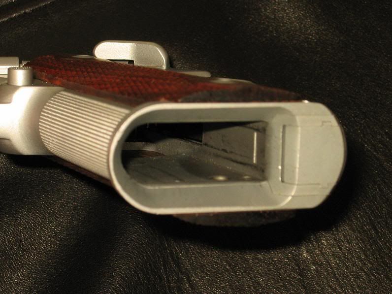

I have a Heinie magwell on one of my guns and all my 1911's going forward will have one. Makes reloads lightning fast yet it doesn't any length or width to the gun. A win/win scenario in my book. With the Heinie you can use any standard milspec MSH including the ones with a lanyard loop.
Pardon the poor picture.
thanks for the post, it looks like the magwell is strictly an add on piece? If i could have a choice, i would like to stick to a one piece msh/mag-well
