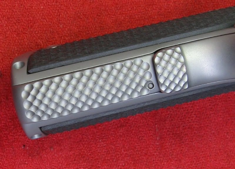

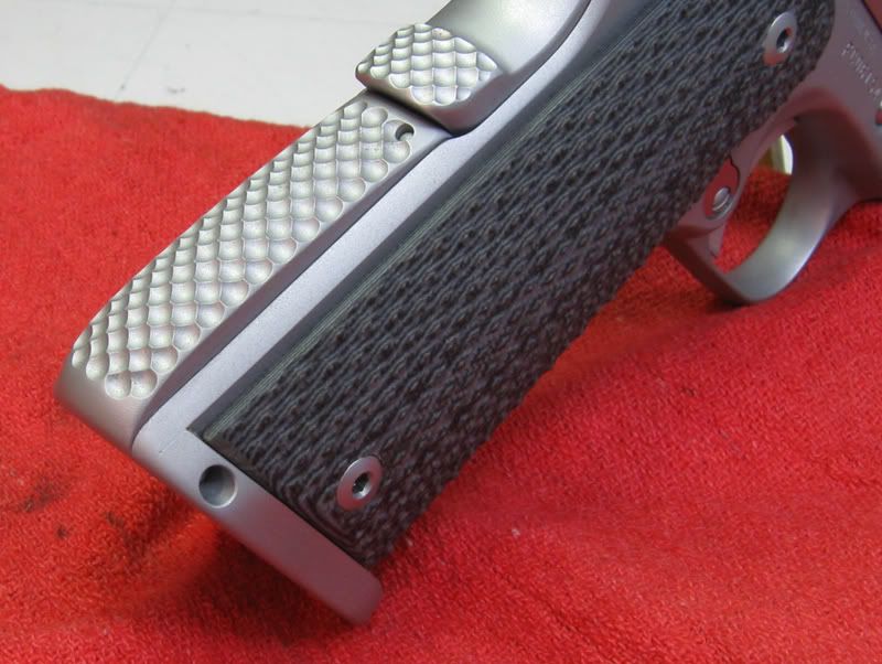

Your work is nothing short of world class...period. Its nice to see the golf balling on an
ARCHED main spring housing. Have requested a 'treatment' on an arched mainspring
housing before, and was told, 'it can only be done on a flat housing, not an arched one'.
I have big hands so I need an arched housing...flat wont 'cut it'. (So I have to settle
for serrations or checkering...no other options?)
Im just saying, its refreshing to see a world class smith, 'just do it' ... and executing
the treatment perfectly too! The Colt is gorgeous from top to bottom, the hard chrome
is beautiful! (Please share the build sheet with us)

Brown’s arched mainspring housing. Golfballed.
Rogers’ weld on magazine well.
Grip screws and bushings.
Davidson G10 grips. Black and grey.

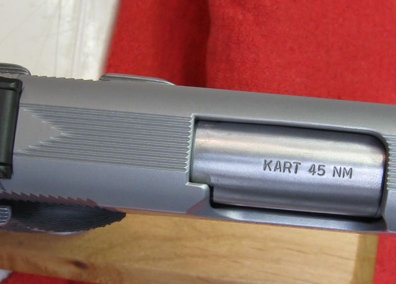

Some of you with sharp eyes may have noticed what looks to be a gap on the left side of the barrel hood. I'm embarrassed to admit that the pictures were taken with the wrong barrel in place! :oops:
I sent out two barrels for hardchroming and in my haste to get some pics taken, temporarily installed the wrong one. I never noticed it as with the exception of the hood width, the two were virtually identical. I discovered this when re-assembling the other gun, as the barrel would not fit! Of course, there is no way that the gun would leave my shop in that condition.
I employ a non-traditional method of barrel fitting and machine the hood width to match with the slide recess within a thousandths (.001") or two.
This involves first 'blueprinting' the slide to determine the exact offset and then machining the hood to match.
Uuummmmm, yeah. Actually, that one did get by me the first time. But thanks for pointing it out. Very interesting detail, Chuck. :)

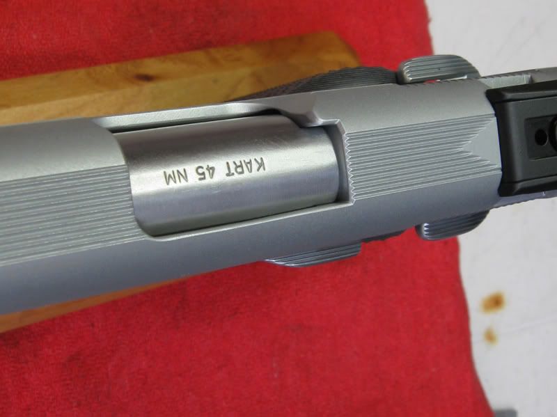

Here are some pics taken this afternoon.....with the proper barrel in place.

I really like the work on the MSH. Now people will have to decide between flat, arched, or contoured.
