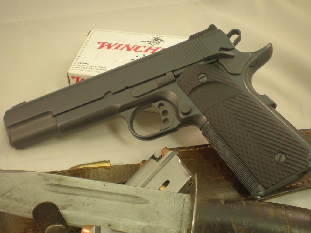

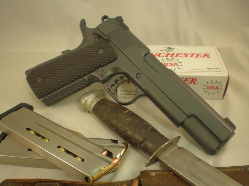

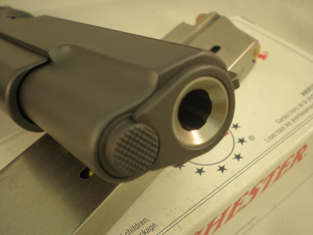

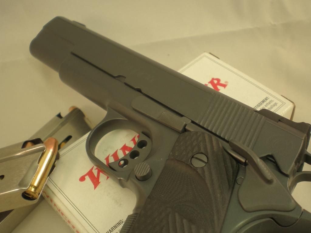

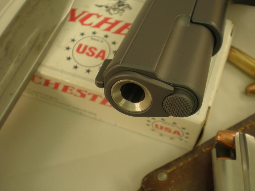

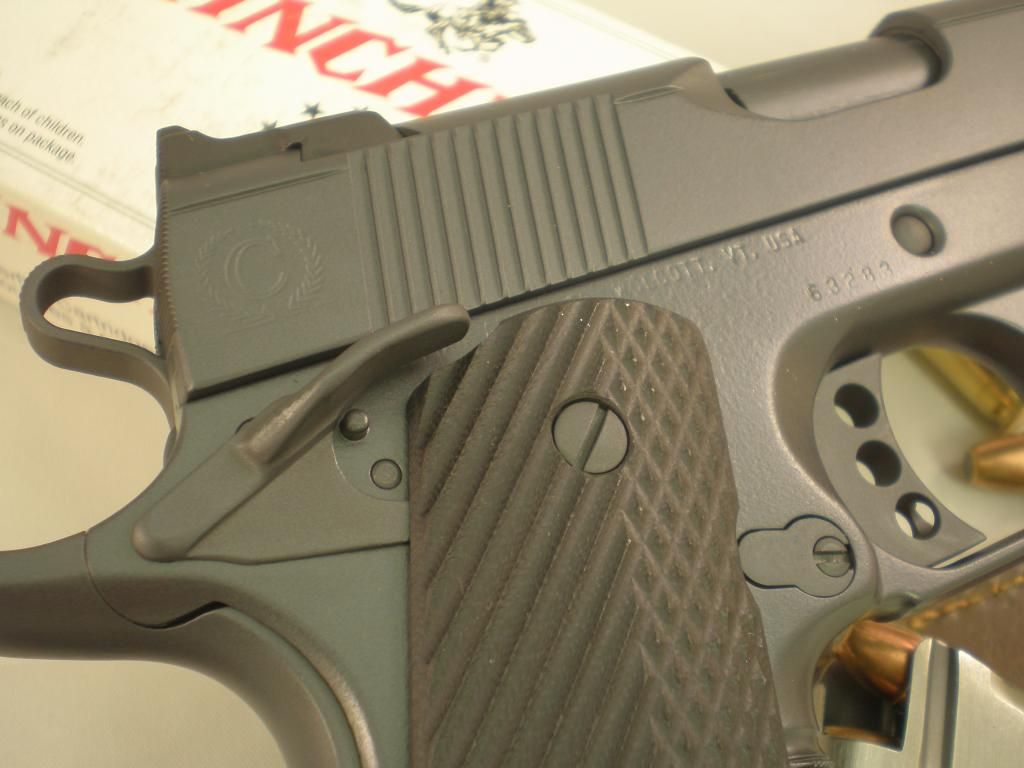

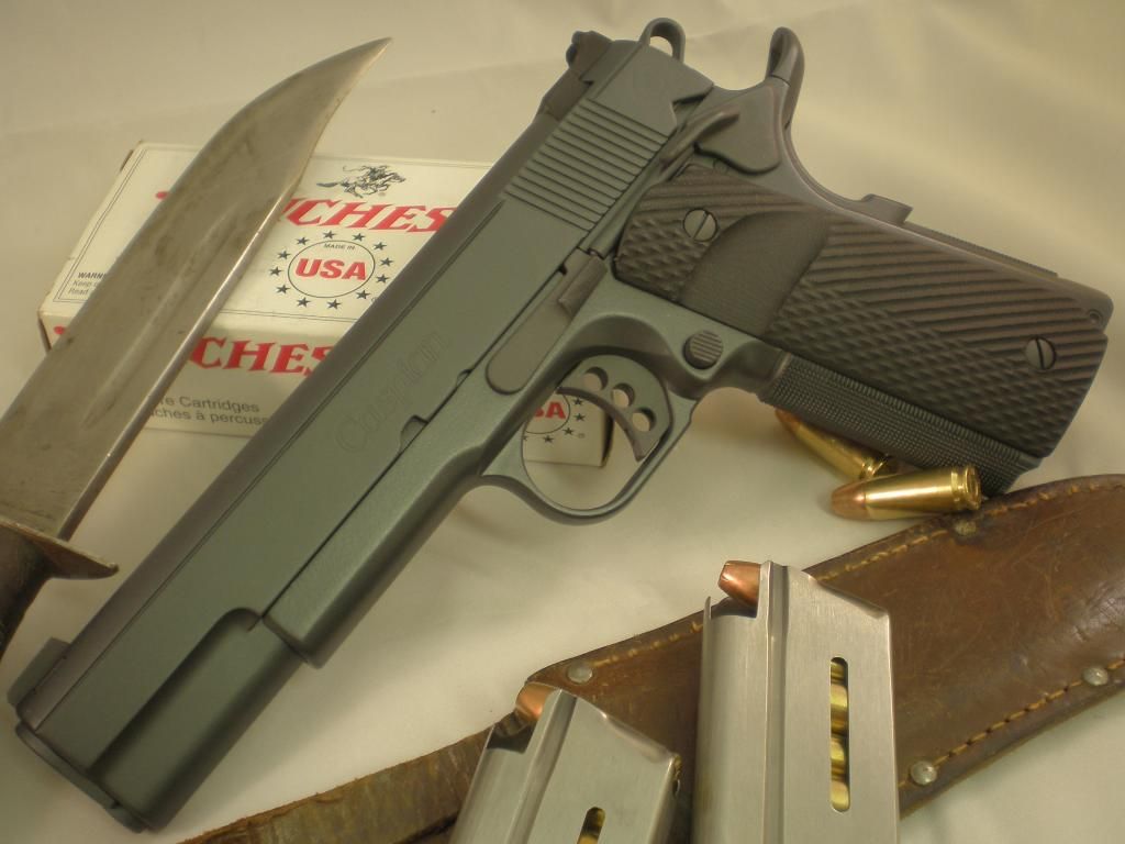

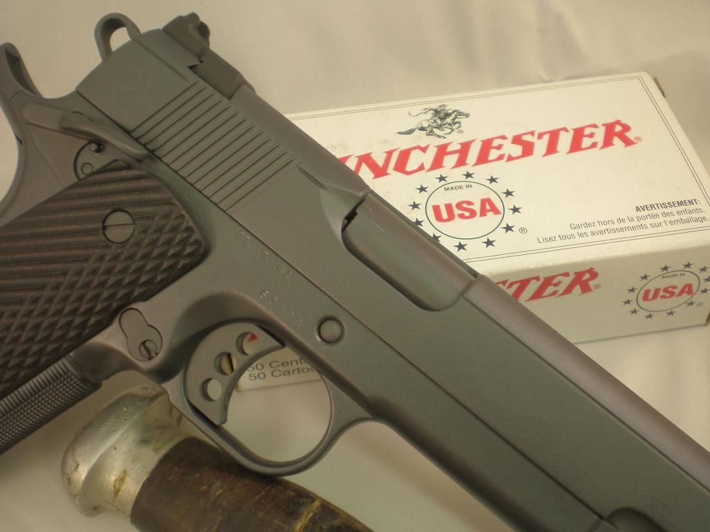

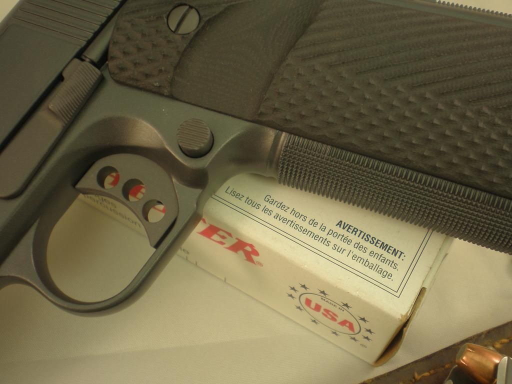

Barsto 9x23 barrel
ball cuts
french boarder

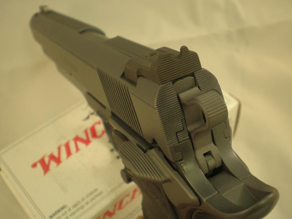

flat top and serrated slide top
ball cut slide stop and hand serrated bottom pad
chamfered slide stop and rounded shortened slide stop cross pin
positive stop ambi safety pin (thanks chuck rogers for the info :)

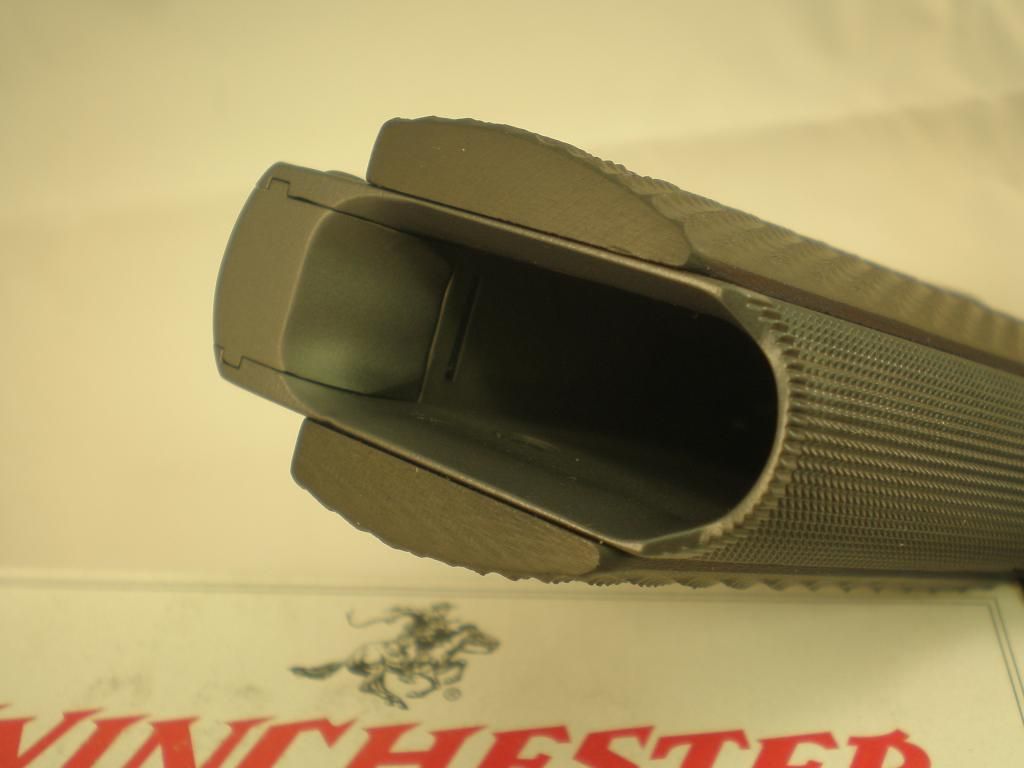

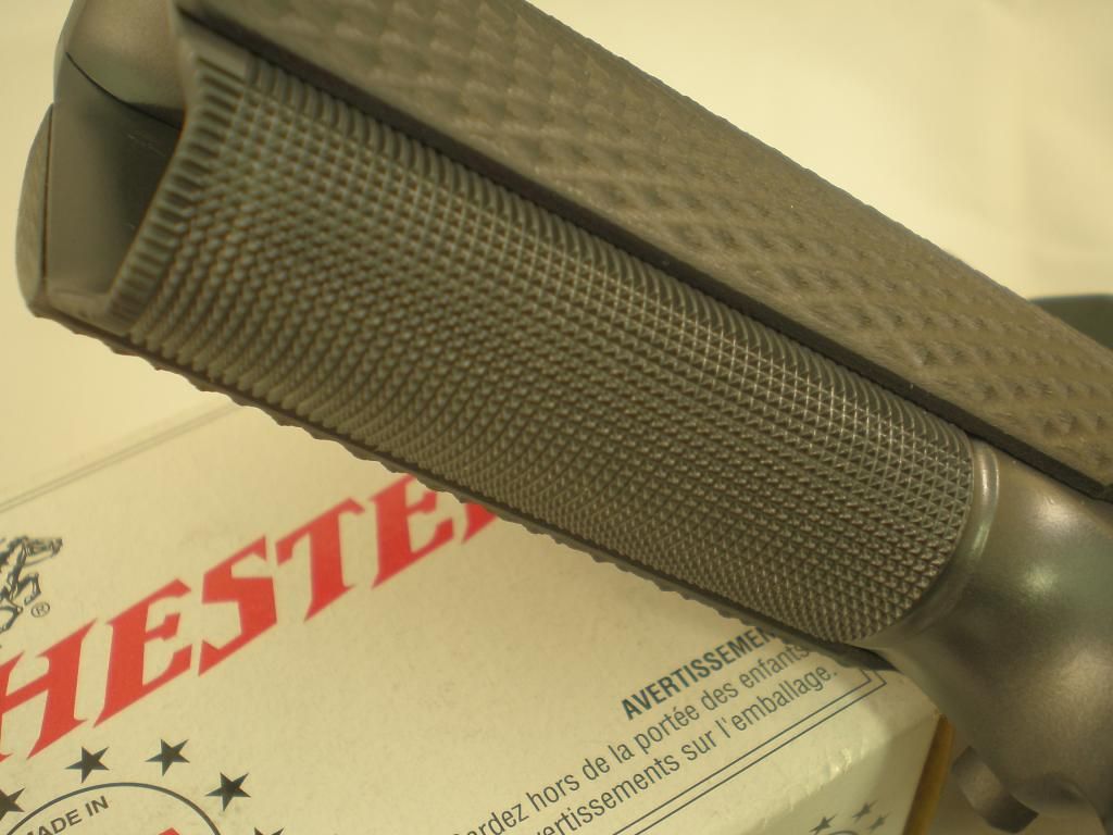

hand checkered front strap at 25 lines per inch
hand checkered mainspring housing at 25 lines per inch
hand serrated rear slide face at 40 lines per inch
shortened thumb safeties
Man-O-war rear sight which is combo of my favorite sights, CT Brian, 10-8, shovel head and warren tac.
flush cut and combat crowned barrel
heavy carry de-horn
VZ operator grips
Novak night sight front
marvel cut (thanks Joe chambers)
Parkerized and coated in house
etc..
the knife is a 1942 or 43 merchant marines knife...dont know Mary and his wife's name is Iva.....sooooooooooo.....yeah :)
hope you enjoy,

Very nice firearm. What mags do you use?

Very very nice, BTW, what color are those VZ grips?

thanks gents,
The magazines are Wilson combat 38 super, and the VZ grips are black.

Wow. Just...wow...
I didn't mean that in a good way.
