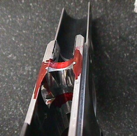

New feedramp inserts. Mill…. saw…..
Grind…..
Fit…. It blues off nicely at the bottom and is a no-wiggle fit. Wait, what’s that hole for in the bottom of the pocket….?
And what’s the weird punch for?
Gotta have a way to remove the insert.
NAK55 steel, kinda uncommon but made for good machineability despite higher hardness (~40), and great polishability.
If and when I need more of these I will just have them wire EDM'd to shape. I have thought about offering them as a part but I just don't think many people would want to do the delicate and tedious job of milling the frame for it. I have what might be an easier solution but the idea behind this one is that noting shows from the outside and it's not held in my a set screw. As seen here it can't move down, nor to the sides, nor back or forth, but it could move up. What is not yet seen is that there is a fore/aft pin that will hold it down. The pin hole is drilled and reamed from the front; the hole has a step in it so the pin cant' pass through toward the rear. Once in place it is staked in on the VIS. Even it if did try and come out forward, it would be prevented from doing so by the rear of the barrel foot. Pretty sold, but-- a lot of work.
Why go to the work...? The feedramp on this one was the best I've ever seen from Colt with regards to dimensions and angles, but it was awfully rough. I don't have much personal experience with LW guns but I do know we don't want a feedramp with the anodized layer polished off. Ramped barrels, just not a fan and they don't go as far down as I would like. For 9mm where the feedramp doesn't have to be so deep, maybe.

OCD, sorta. I just can't resist a rabbit hole :-)
There won't be any Loctite in this.... although if the insert wound up with a little bit of wobble to it I mightn't be above putting some in there.
Insert pinned in, barrel bed surfaced down to match "existing", rear-facing area recut to match existing front radiused part of mag chute.
Feedramp cut and polished "phase 1". Stoned 300, 600, and rotary work from there. It's better than it looks but will need some touch-up anyway before shipping. Taking pics through a 4X loupe all the dust, lint, and oil jumps out.
I'm glad I made a bar of this shape because honestly I don't really want to do it again. I have one more to go and that's probably it (unless it's for my favorite customer, "me".) It's just too much work, even though the result is good.
Make feedramp inserts. Make a mistake? No biggie, start over.
Set up and cut receiving pocket for insert. Rather intense..... take your time and no misteaks!
Fit insert-- a little filing and stoning, probably. Not too loose, not too tight. Tap-in, tap-out kinda thing.
Drill and ream stepped hole for retaining pin. Goes from VIS through feedramp insert, out the back, then reamed a little bigger for the pin. You can see it coming out the back, nothing is gonna catch on that, it's too low and to the side.
Set up and cut barrel bed to match.
Set up and cut mag chute front to match.
Set up and cut feedramp.
Polish feedramp.
Remove feedramp insert and deburr knife edges at the side.
Make feedramp retaining pin-- exactly the right length.
Reinstall feedramp-- finish the rest of the gun, test fire.
Remove ramp, send frame for refinish.
Reinstall feedramp... could be a little tight now. Last time it goes in, probably never to come out again, but it could if needbe.
Nope. It's one of those things I could not possibly charge what it actually takes to do.
