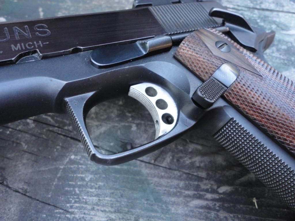

I still love doing squared guards... this is one in the works on a long-term project, still have to checker it and clean up the lines.
