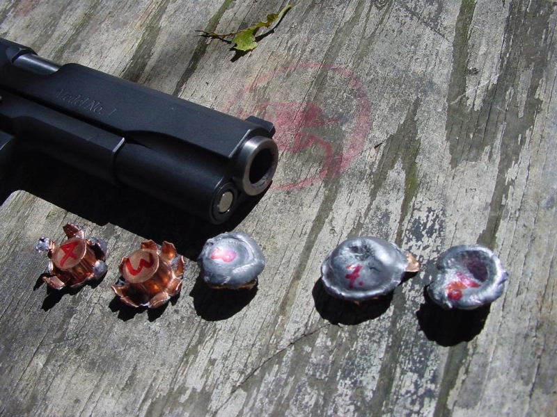

As an update for anyone interested, I recently had a chance to examine and shoot another .50 GI, in fact I was able to get some hollowpoints into calibrated ballistic gel, and a few others into some of your typical backyard ballistic guru media. Once again I say, disclaimer disclaimer disclaimer, I do not pretend to be an expert on this kind of thing, but I basically badgered these guys into letting me fiddle around a bit with bullet design. This gun is about 60 pieces subsequent to the one I had before, going by the s/n, and was identical in every way as far as I could tell.
Bullets used were 300 grain Gold Dots and 300 grain IMI hollow-pointed soft points. These IMI pills have a ton of soft exposed lead on the end, and I figured now if ever, I would see feeding issues. None. Even the sound of the gun closing on a full magazine is exaclty what I like to hear-- just "shunk" and not, "ka-shlunk". This tells me feeding is smooth. I once again tried to trip up the process by putting this round on top of a full mag and inserting the mag with the round tipped down-- which it will not do. I could not get the top round to stay in a tipped-down position like you can do with some mags. Doing a slide drop gave the same positive feeding. I took it one supremely unfair step further and rode the slide down under the same conditions, something that of course is discouraged, because it so often causes a feeding problem. No prob with the GI. The mags are truly primo pieces of work.
The above pic shows, left to right, two Gold Dots; the right one
expanded to .978 after 12" of gel, 100% retained weight, the left one went 14" and expanded to .890 or so, smaller than the other only because it over expanded and lost some petals from the side. The other bullets are the IMI pills mentioned above, some modified and some not.
Rereading my original post I see I said something like I didn't want to be seen as promoting the .50GI. That's not exactly how I meant it. Obviously I like it and am promoting it, what I meant was to reiterate that this is not a product I have any stake in, and although Alex is a friend, my interest in this is based on what it is and not who it comes from.
