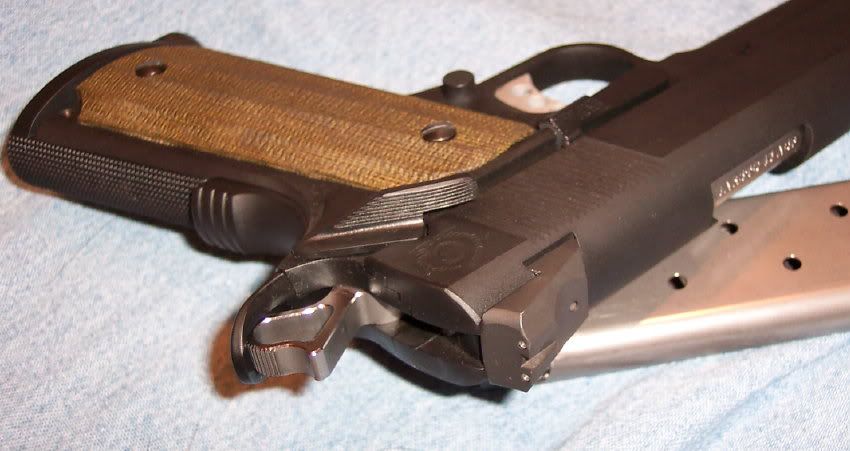

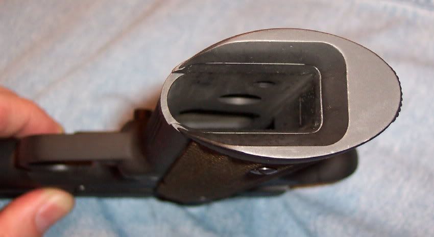

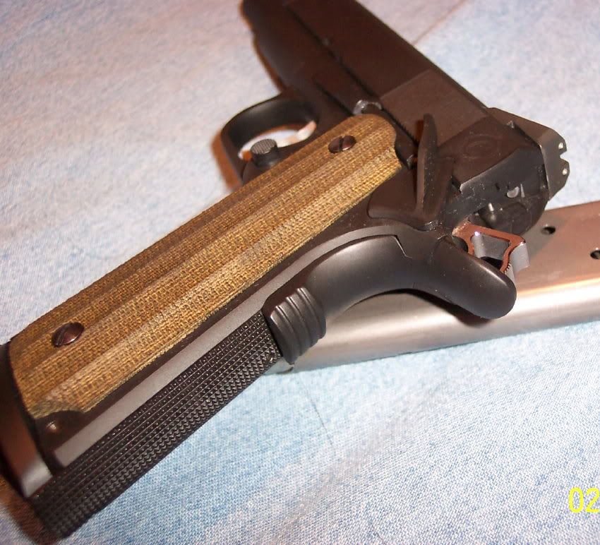

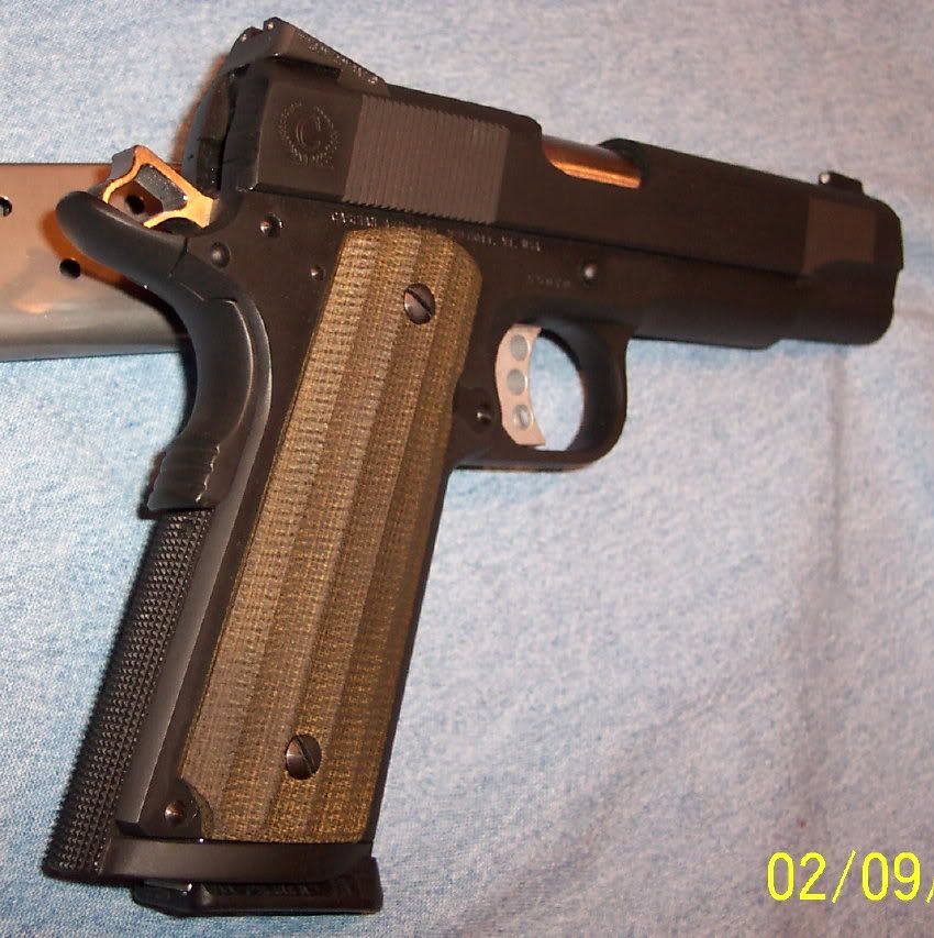

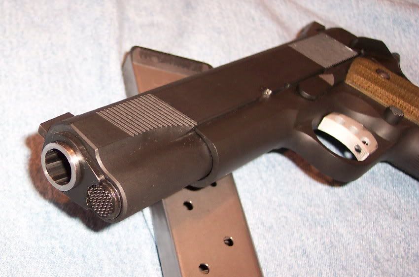

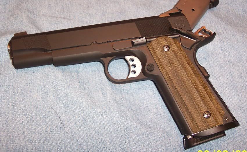

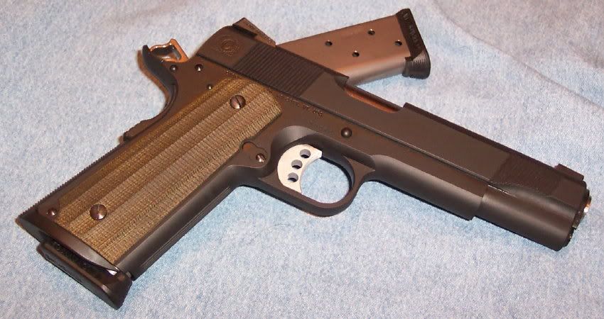

A few months ago, I mentioned this project on this site. I finally got the pistol back and I thought I'd share details and pics.
Last summer, I was in a gun store in Woodbridge VA (Quantico Arms) and was discussing custom pistols with one of their part time employees. QA frequently hires young Marines to work a few hours a week in the shop. This particular Marine has an administrative job currently, but is friends with a Sgt. Albright who is a 2112 armorer at Precision Weapons Station, Quantico. PWS builds the sniper rifles for the USMC. They also build the DMR (customized M14) and the MEU(SOC) pistol. I'm assuming everybody here is familiar with the MEU(SOC) as its considered by many to be the holy grail of combat pistols.
Well, it turns out there is something called the "Hobby/Lobby" program. This is a program that allows the armorers to legally take on side jobs. They can't use government time nor parts, but can use the shop. This is actually encouraged so they can keep in practice on all the weapons systems they build and service.
This young Marine I met at QA agreed to help me get a 1911 built under this program. In short order, I had all the part to him. There was a long delay from Caspian on the frame and that pushed everything into the holidays.
I got the pistol back late last month. It wasn't quite what I wanted, but was close. The mag catch wasn't working well, but that was my fault. I selected a CMC part, not realizing it was MIM and the armorer didn't want to mess with it. The slide stop was also not right as it was a cast part and had a seam right where the the detent rides (EGW part). I replaced both with Ed Brown parts. The finish also wasn't quite what I was expecting. KG Coatings has a new ceramic based finish that isn't commercially available yet so my young Marine contact bought a bottle in satin black. The satin was very glossy and just didn't look right. The Marines have been playing with this finish for a while now and its proving to be VERY hard and durable, but the satin just doesn't make the grade. We got a bottle of flat black.

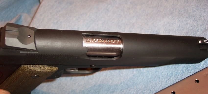

With the new parts and new coating, it went back for final fitting. I got it back on Thursday night and I'm stunned. Its perfect. The grip safety is nice and sensitive, the trigger breaks at 54 ounces, the back of the slide is blended to the frame and ejector, the beavertail is perectly fit into the frame, the mag well is beveled and the finish is flawless. Its exactly what I want in a combat pistol.
A couple of word on the choice of equipment... I chose the front serrations because I really prefer the press check from below. I chose the non-ambi safety because I'm not a lefty and don't need it. I chose the Wilson rear sight because I like its profile and the fact that the tritium is yellow so it contrasts with the front. I don't like sharp checkering on the front strap as it eats up my hands when taking a class but I did want some texture and selected the serrations. The Brown's grip safety is preferred for my grip and its also what the USMC uses on the MEU(SOC) so I knew they would do it right. The magwell is there because I shoot my carry gun at IDPA matches and this has really improved my reloads.
The specs:
Caspian frame with frontstrap serrations
Caspian slide with angled, Colt style serrations front and rear with Novak cuts and carry bevel
Bar-Sto barrel, bushing and link
C&S internals
Kings thumb safety
Brown beavertail
Brown slide stop
Brown mag catch
Brown extractor (and a spare Caspian one)
S&A magwell
Novak front sight
Wilson rear sight
VZ Gatorback canvas grips
Here's the pics:

I did shoot it before it went back for final fitting. I wasn't able to really wring it out but it was showing signs of being every bit as accurate as I would expect a combat handgun to be. The slide was not locking back and that was a distraction so I never really got into shooting hollow points and other odd-ball ammo.
fit and finish? Excellent. Its tight, but not so tight that its hard to cycle by hand. The best word I can use to describe the slide to frame fit is smooth. Its glassy smooth. The beavertail and back of the slide are very nicely blended. Its actually a lot better than I expected. I figured the USMC would put more emphasis on reliability and not worry so much about aesthetics so I was pleasantly surprised at the details.
Would I do it again? Absolutely. I paid for all the parts and they cost me around $1400. Assembly wasn't free, but it wasn't bad either. Worth every penny IMHO.

Great gun Cliffy! I really like the smoothing of the front of the Novak sight- I've never seen one done like that and it looks fantastic.
Ted
Are you referring to the front edge of the rear sight? That's not a Novak sight. Its a Wilson Combat. I put those on the rear because I like the profile better but mostly because its yellow.

Oops! I missed that part on the Wilson rear sight in your 1st post. Overall a great looking gun!
