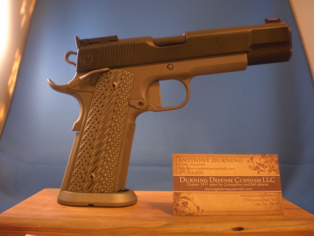

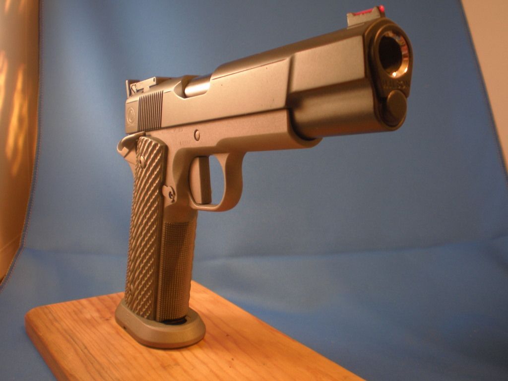

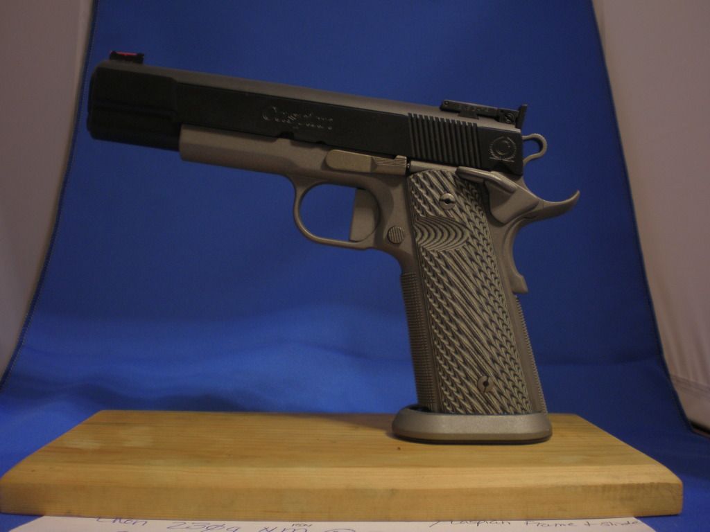

This is a pistol I built for a client on the east coast, will be showing up at some matches later this year.
Fun gun to shoot and turned out well,
Wilson 45 acp barrel and bushing
Caspian frame and slide
Wilson fire controls
10-8 flat trigger
Wilson G/S
Wilson ambi safety
all good tool steel parts! etc..
Ball end mill cuts
french boarder
high power cuts to match 15 degree slanted Caspian serrations
High cut front strap
20 lines hand checkering
Dawson Ice magwell at customer request
2.5lbs trigger pull
Chevron pattern flat top serrations
bobbed slide stop cross pin
Marvel disconnect cut

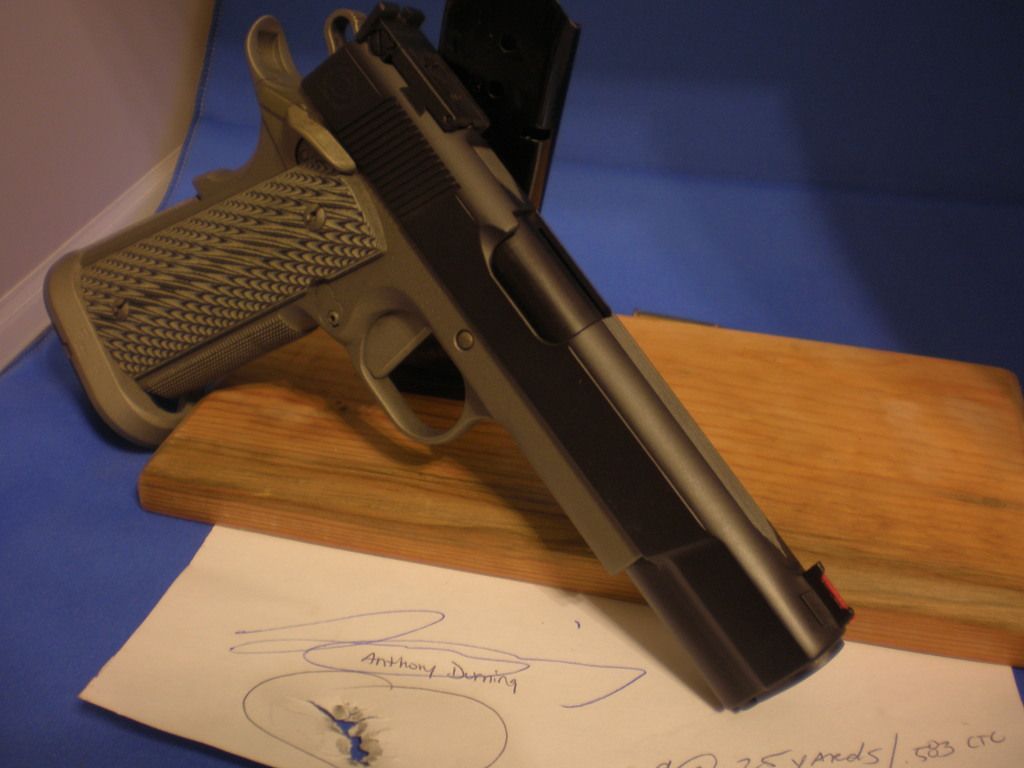

Range report
500 round test fire with no malfunctions
5 shot group @ 25 yards using a ransom rest
.583 Center to center/ using Chen 230gr NM RDN (good stuff I might add!)
all in all, shoots well and should get the job done! thanks everyone and your feedback is always welcome!
