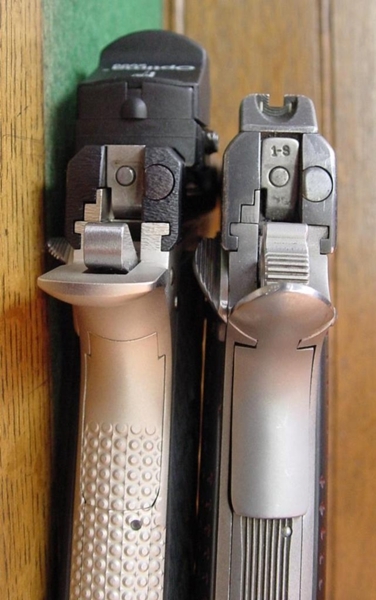

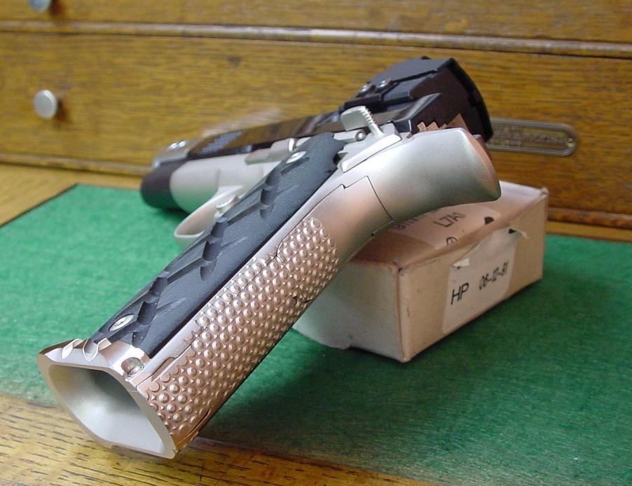

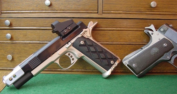

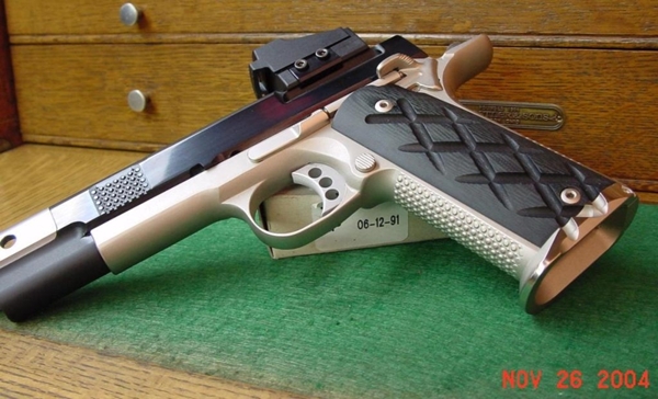

This is something I snuck in several months ago, just got it back from refinish, and although it is not quite 100% complete still, it's done enough for a few pics.
The idea was to see how low I could get a 1911 in the hand. Alex Zimmermann and I have discussed this off and on in recent years, and, anyway, this is my take on it. I think I could go lower still actually, but not too much. Won't be surprised if Alex woops up something that beats it, if he can find the time. That's always the problem isn't it? I know a lot of us come up with ideas that could be something, but finding the time and money to try it and get it rolling is always a major hurdle.
In a nutshell, I came by a cheap 1911 where the top end had basically been destroyed, and the frame damaged, by somebody starting at the base of the gunsmithing learning curve. Not the kind of thing I normally would have any interest in, but I decided I could use the frame as a test mule and finally give this idea a try. With this frame, I could cut and weld and bend and recut and reweld; it was something I could scrap out and not have to worry about atoning for if St. Petersstahl should question me about it. The first whack at it went fine and I thought, dang, I should make a gun out of this. I started gathering up parts-- some take-offs, a slide I had botched the sight cut on and replaced for the customer, and a .355 Hybrid Commander barrel I bought from California Competition Works at the last Second Chance shoot. The latter two I'd been saving for myself as I have for some time wanted to put together a 9mm steel gun.
So-- here are some pics, more comments later. For comparison, one pic has a 1911 with a pretty high-cut Ed Brown grip safety installed, another pic shows a bone-stock Colt. This gun is at least 1/2" higher than stock.

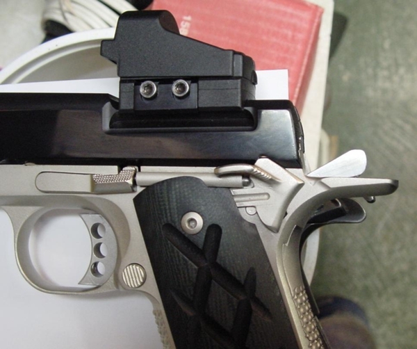

Anthony, here's the scoop on the safety, but in return I'd love to see a pic of that Boland. That guy had some skill and imagination now..... but I believe his work was not seen very much outside of CA.
In the process of making this super-high, well, the safety pivot hole was removed. I mean, that part of the frame is gone, so, now the safety pivots from the front. It extends forward, and there's a new hole in the frame at about 10:00 from the grip screw bushing. The arm of it has a little round protrusion that drops into this hole, and it's held on by the grip. The new safety is fabbed from an old safety and an old slide stop for the extension arm.
I came into a bunch of G10, but it's an ugly faded green. Chris at Blind Hogg was kind enough to make a few sets of grips for me, and this is one of them, made ultra thin and then grooved. Then I dyed them black.... the dye only penetrates a few thousandths. I then sanded the outside back to light green, and then dyed them dark green, so they are sorta dark green with the grooves black.

Even with the high-cut front strap, doesn't it tend to point high?
PostPosted: Sat Nov 27, 2004 5:48 pm
Posts: 4435
Glad you guys like it. Part of me has been anxious to spring it, the other part said waiy and put it on the table at SHOT.
It does not point high for me, but I am still getting used to the Optima. I shot several pin matches with it last winter after it was mechanically ready and always had trouble finding the dot for the first pin. After that things went pretty fast and the only real trouble was the risk of starting the ceiling tiles on fire.

Did you move the firing pin retaining plate forward?

Couple more tech details BTW, the mainspring housing is a Caspian cast aluminum one for their hi-cap frame, so it has a little forward step allowing me to cut into the rear web of the frame's mag chute towards the little slot that retains the sear spring..... in the bottom of this cut then, the step in the MSH comes to rest. This allows one to open the magwell way out in back without getting a knife-edge of steel on the web. I had bought one of these MSH's seeing that it has the step in it that I usually fabricate onto an MSH for this purpose. It does not go as deep as I'd like into the frame, so I never used it and continue to modify existing MSH's, or, when an aluminum one is called for, I make it from scratch. But the theme of this gun was to use as many existing, lay-around parts as possible and to keep it something I could put together keeping the time and money as low as possible.
The beavertail is a piece made from scratch and T-slotted into the frame. My original intent was to leave it as a separate part, but I found that even with it in place, I could still wrangle all the guts in and out, so I silvered it in place.
The piece between the beavertail and MSH is just machined out of 7075 aluminum, and heeled in under the beavertail on top, then retained on the bottom by the top of the MSH, the part that usually stops the rearward movment of the grip safety.
The magwell's made from scratch and silvered on. Richard, no, there's nothing different about the firing pin stop other than having been cut off a little on top. eerw, you asked if it was experimental or would I be offering it? Both, sorta. Actually I am having "experimental" engraved on it just for the hell of it, but, yes, I would do it as a custom mod ( but have not really considered what to charge), and have spoken to some folks about doing frames for me and plan on talking to some more at SHOT, but don't read too much into this.

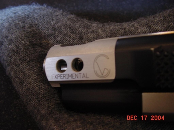

The comp is machined from 7075 also, and had a slight, ah, booboo in it. The diameter of the expansion chamber sorta collided with the the flat on the bottom, me in my enthusiastic rush having failed to consider this relationship. The result-- a window in the floor of the comp. But no biggie, really-- the recoil spring plug has a flat piece silvered to the top of it to fill the gap between the slide's barrel bore and recoil spring tunnel, so when the gun's in battery, the window is closed by this flat piece. It's pretty much a no-gap fit so it seals it good enough; anyway, after the barrel ports I don't think the comp is getting as pressurized as it otherwise might and is probably contributing very little to the overall recoil and flip reduction. This flat piece gets a little sooted and fouled up where it's exposed to the gasses, but not so bad that it'll interfere with functioning, at least not it 200 rounds or so.
I sent it to Ford's for refinishing. I wanted something that would cover the silver joints well, that meant nickel, and I wanted something that would plate the aluminum parts equally as well as the steel. Horace told me "Watts bath" which I gather is regular old nickel electro-plate, the kind you'd find on a Colt or Smith& Wesson, with copper plate under it as a base. This gun I believe has electoless nickel under the electro plate. Indeed it is impossible to tell the dif between the steel and aluminum parts, and coverage was 100%, I mean even in the holes. A very, very nice looking finish. I had them blue the slide and a few other little parts. Nickel is not as "white" as chrome, which i think some people don't like. I'm not expecially partial to either one, they both have their cosmetic and functional advantages, but the nickel looks a little "warmer" to me.
The Optima is mounted to a short length of Weaver rail that is simply machined into the top of the slide. There is a 1/8" pin hidden under there to locate it and keep it from migrating forward.

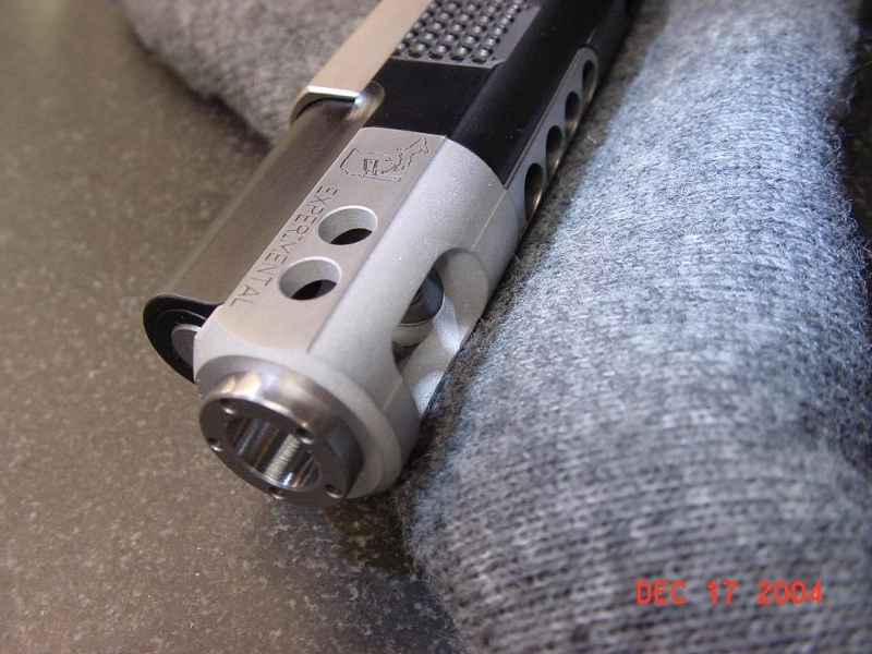

I'm not trying to perpetuate this thread but had a few more pics. In the first pics I purposely kinda avoided the front end as the comp was not completely finished and engraved. Got it back and here are the final pics, which are not very good compared to the others, and of course, way below That Bailey Fellow's standards, but OK enough to show the engraving. The left side logo is the customer's monogram.... even though this is sorta my gun, it is sorta also for a customer.
